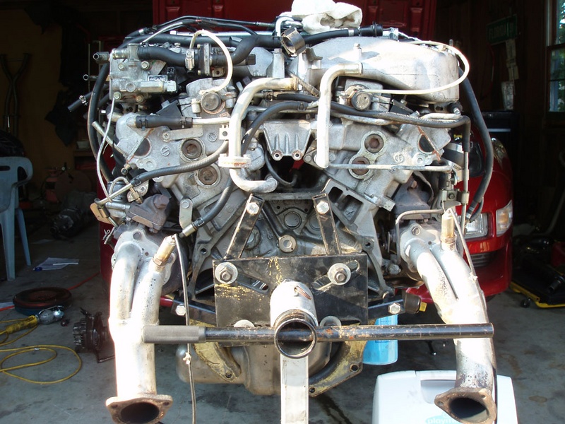

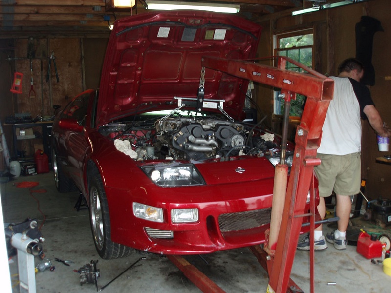

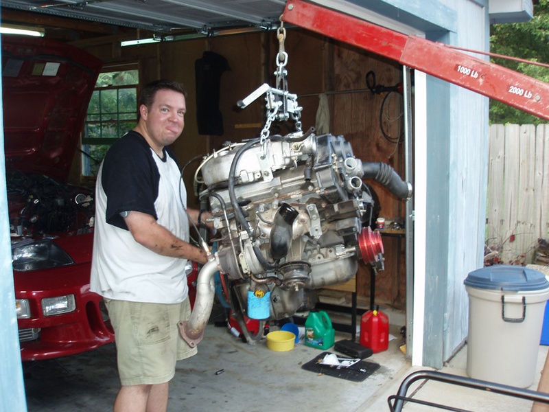

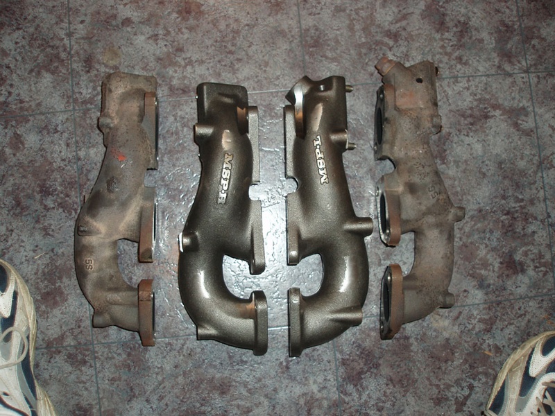

What is that guy doing to my engine?!

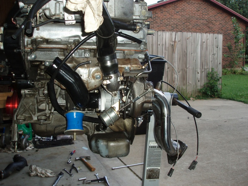

Dunno why, but i love the backside as much as the front.

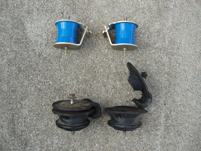

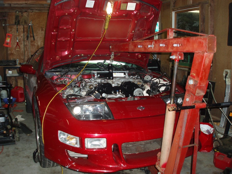

Doh! Had a broken motor mount.

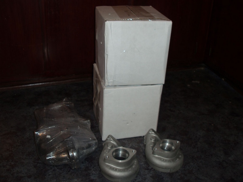

Whats this? A box?
oooo goodies from Mike Smith!

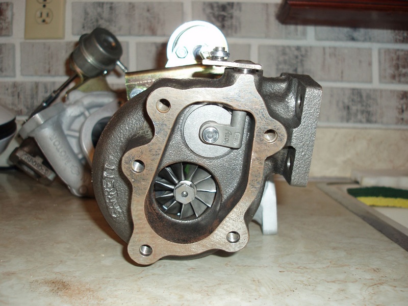

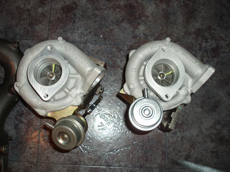

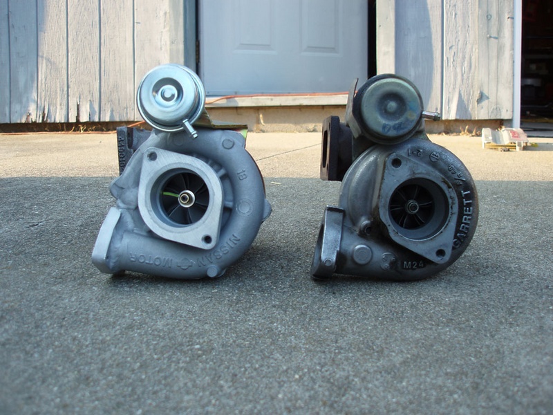

These are S14 Silvia turbos fitted with Sport 600 compressor housings, thanks to Mike. vs. stock on the right

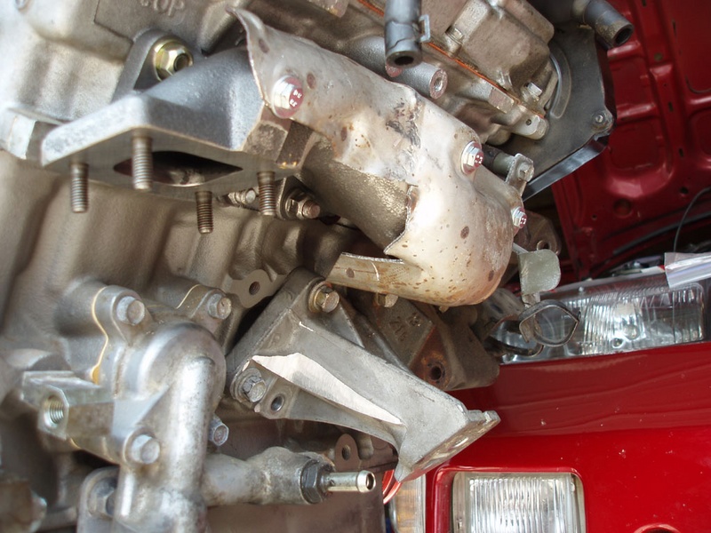

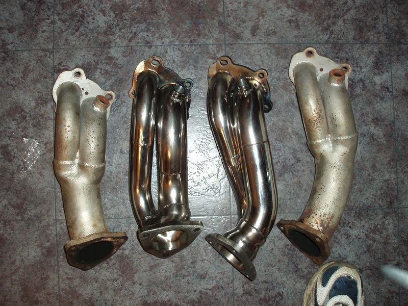

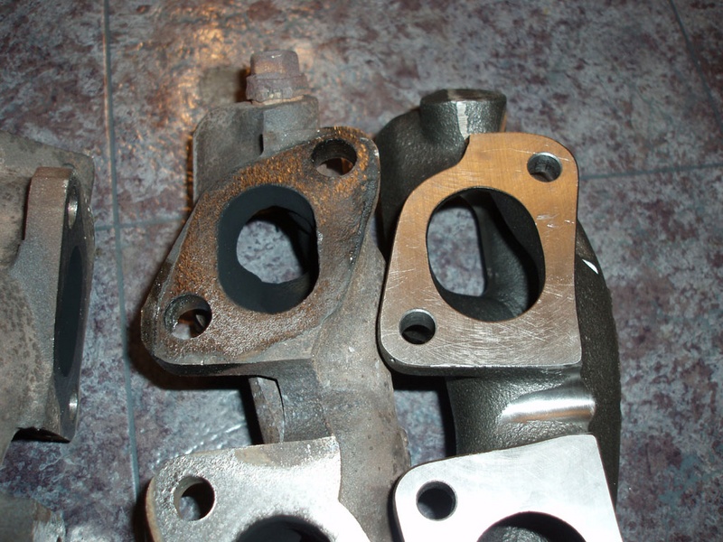

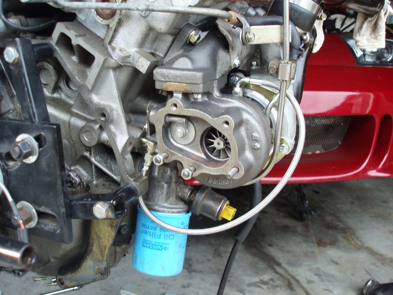

Butchered heat shield and grinded down motor mount

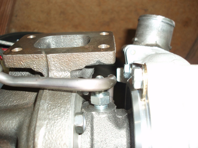

I had to notch out a piece off the turbine flange to accomodate the GTBB oil feed kit, i wasn't expecting that, but not very hard to do.

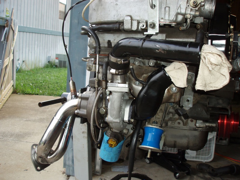

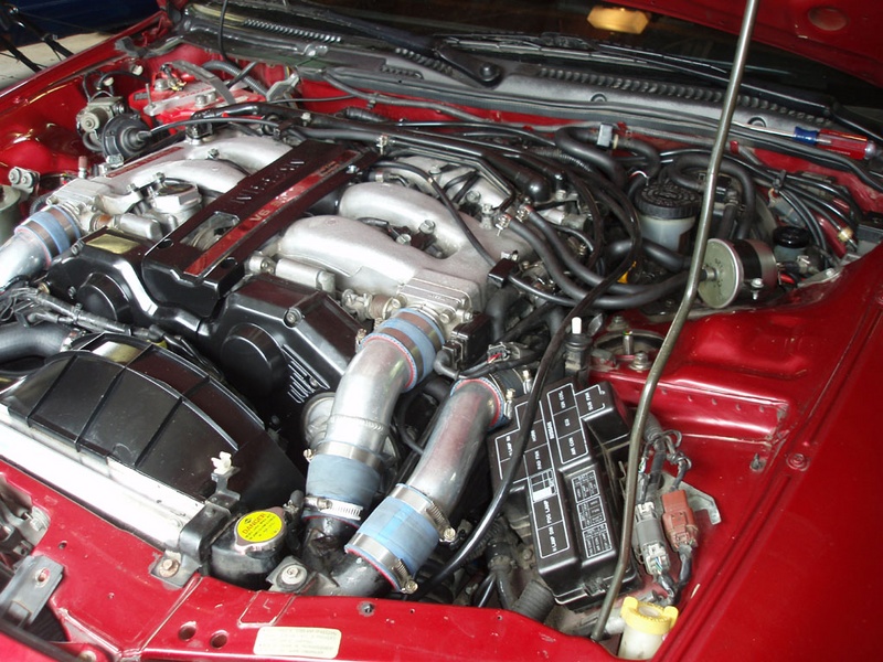

Passenger side fitted up:
Goin back in.
Cleaned up with some painting and scrubbing.

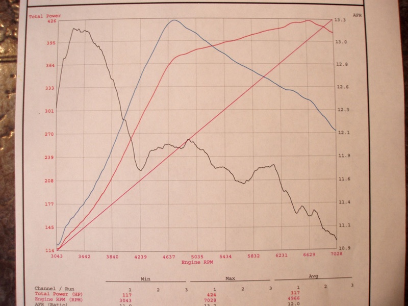

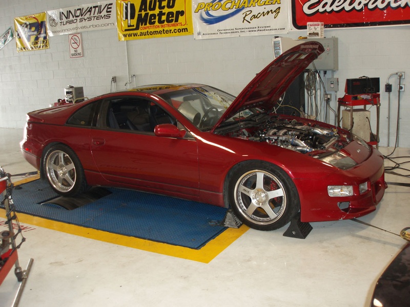

Dyno time!
Thats 426 rwhp and 412 lb ft @ 18.5 psi on 93 octane. The tune stays under 12.1:1 the entire time and EGTs stayed under control.
These turbos are GT25 ball bearing catridge, with a 60 trim .60AR compressor and 62 trim .64 AR turbine.
I gapped plugs to .035 and did a compression check before hand, which was:
1: 154 2: 145
3: 152 4: 145
5: 146 6: 144
With some tweaking and rechecking i'm sure i can get to mid 400s at the wheels on pump. Also consider it was 90 degrees ambient.
